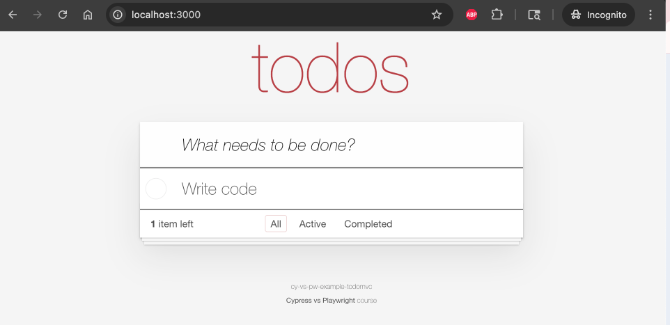

TodoMVC application with a single todo item
The test can assume that it starts with zero items

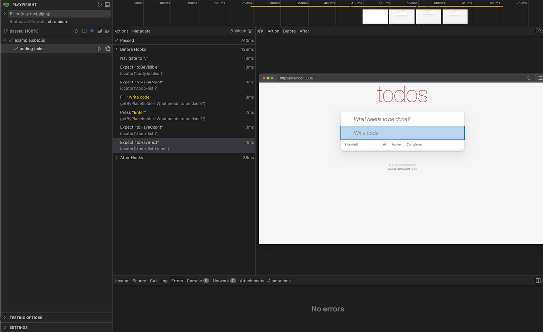

Here is the finished test running in Playwright UI mode (we will look at the test runner modes later)
Playwright test that adds and verifies one todo item.
Playwright tests follow a simple formula:
await <command | expect assertion>

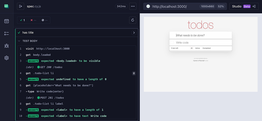

We will simplify the locators in the future days of this calendar. Meanwhile, let’s look at the Cypress solution to this test.

The test passes, here is a screenshot from Cypress interactive mode
Cypress test that adds and verifies one todo item.
You can see how the declarative syntax of Cypress differs from imperative Playwright syntax. A typical Cypress test simply “declares” what commands to run and what is expected from the web application page:
cy.command(…)
.command(…)
.should(assertion)
